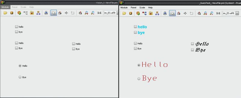

I have a stylesheet.css file in config folder. If this file is empty i have no problem when i configured radiobox and checkbox with diferents fonts, colors, font size.
When i put anything inside the .css file, for example this:
QPushButton
border: 2px solid rgb(0, 0,255 );
background: qlineargradient(x1: 0, y1: 0, x2: 1, y2: 1, stop: 0 #0A78E7, stop: 1 #FFFFFF);
border-radius: 7px;
font-family: "Arial";
font-size: 16px;
font-style: bold;
all style of the radio buttons and check buttons of the project change to get the same font, font size, color...etc..I don't understant this..
If i configured in the stylesheet.css a configuration for checkbox and radiobutton, all radio buttons and check box in the project gets this configuration correctly.
How can i resolve that?
I send a image with a panel start with .css and a second panel start without .css
The .css only contains the configuration of the QPushButton write in this message.
Thanks!

Re: stylesheet.css
Thanks, i know that...but my problem is when i have one configuration in css (push button or other), the object radio button and check button in my application can't change his properties ( size font, font, color font,etc...). if i don't have .css i can change it.

Re: stylesheet.css
I've tried both, to change the properties of one named shape with eg. QPushButton#xxx and with the QPushButton [type = "xxx"]
And it is correct that the checkbox and the radiobox loose their properties. This happens because the QT objects radiobox and checkbox are complex objects and contain more than one object. Normally the MultiLabeledParent inherits the properties to the childs, the QCheckBox::indicator. If you use a stylesheet the inheritage gets lost because QT will offer you the option to configure nearly every property of any used object.
Note: At the moment it is not possible to give several checkboxes and radioboxes a different look.
