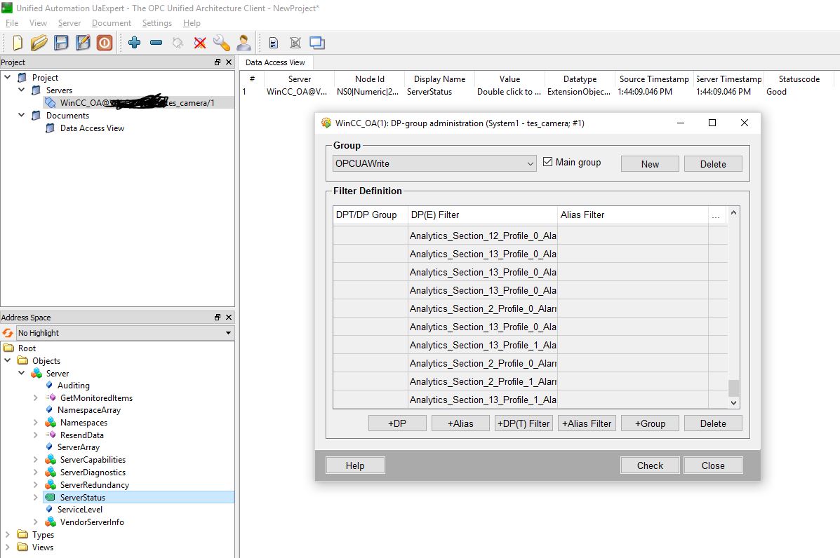

I am in the process of upgrading 3.16 version to 3.17 version. Need to migrate the existing WinncOA OPC UA server to 3.17 version.
While testing the new version, it was found that I could connect to the server, but not able to see the tags added in opcua dpgroup.
config file:
[opcuasrv]
disableSecurity = 1
enableAnonymous =1
Am I missing something? I have tested in both Windows and centos version.

Found the issue. Internal datapoint for OPCUA dpgroups changed in new version.
