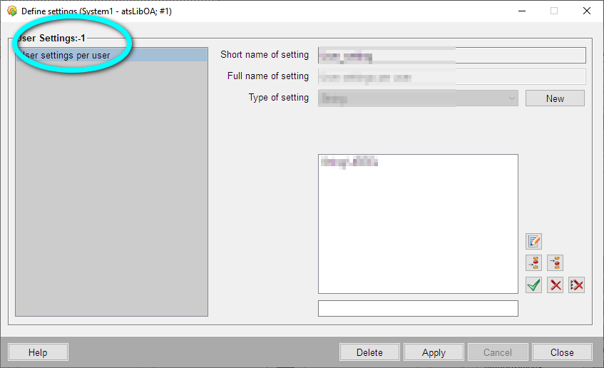

According to the help, settings can be applied per user. Trying to do this, I noticed that the user name for the settings panel would always show "-1", and therefore making user-specific settings impossible.
The bug seems easy:

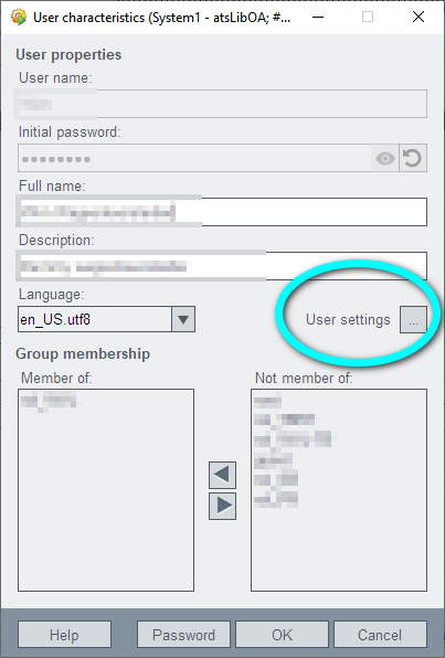

Using the default users properties panel (vision/ud_users.pnl), clicking the "User settings [...]" button, the following panel shows "-1" for username (see screenshots). Therefore, the settings are always saved to the datapoint -1.

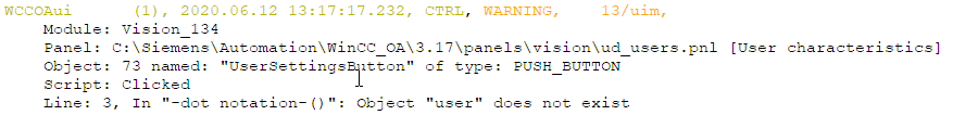

The source of the bug is easily found in the log viewer (see screenshot): the shape simpl has the wrong name. (see screenshots)
--edit: I cannot upload the screenshot of the wrong shapename. Anyhow: the User name textbox is names wrong (or the scripting is incorrect).

UserSettingsButton has a error. It should be "UserNameTextBox.text()" instead of "user.text()"
