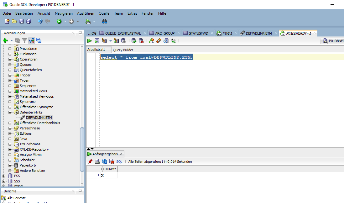

There is no indication in WinCC OA dpes, because the connection to the daatabase is not establisched. What you can do is to preiodically check if the link working. This can be done with an SQL statement from the primary server to the secondary server. There is always a DB link between the two Oracle server.
the SQL would look like following:
select * from dual@<YOURDBLINK>;
you can run this SQL with direct SQL commands periodically out of WinCC OA then (using our built in control functions).
