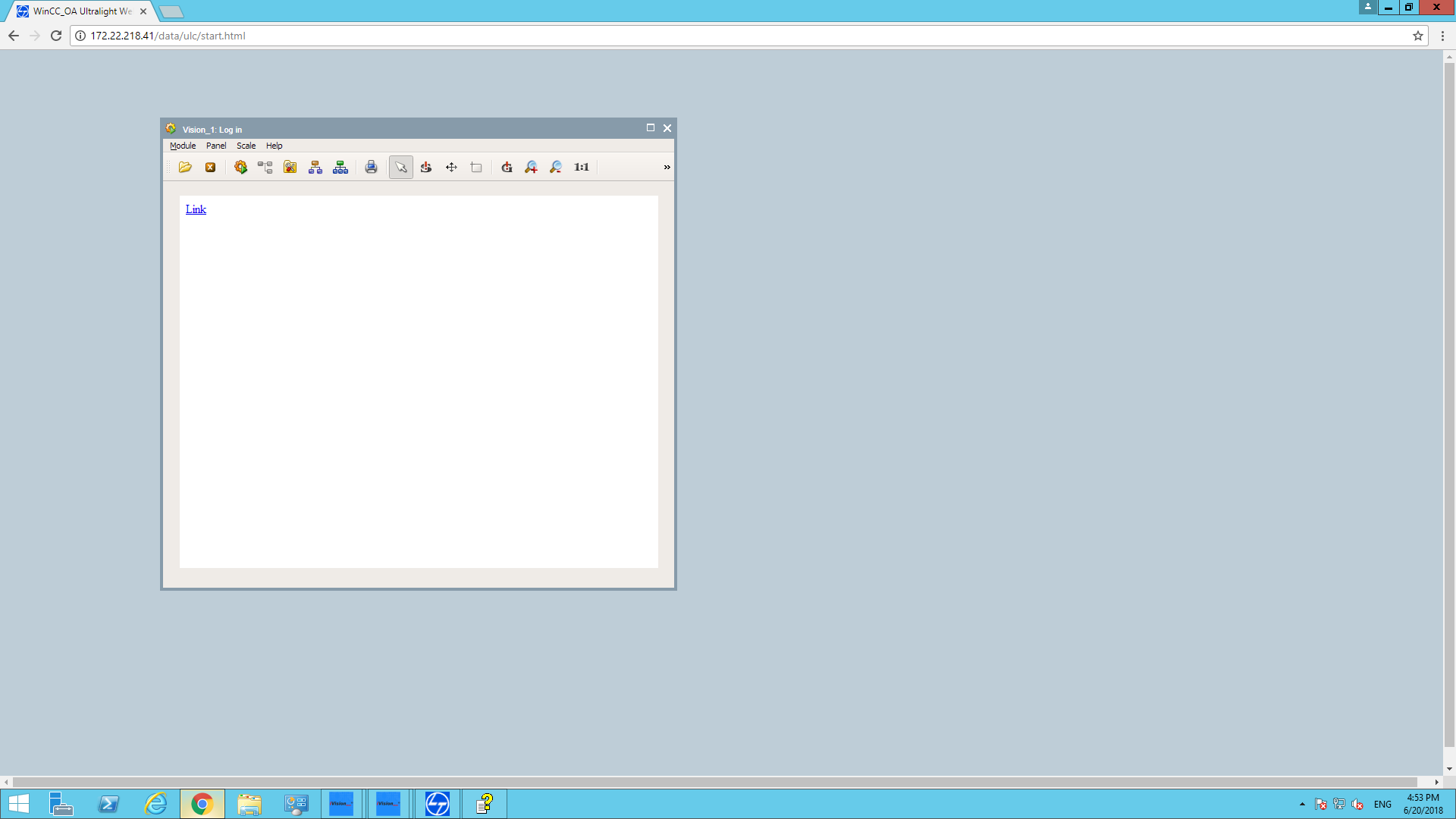

Hi Experts,
I am tring to open new tab from ULC ux, as openUrl doesn't work for ULC ux, I tried to do it through loading html page in webview in ULC ux, link is appreaing in webview in ULC Ux after setting ulcClientSideWidget to false, but nothing happens on clicking that link.
Any work around for this??
Background :- We are using excel reports in our project, as generating excel report from ulc ux is not possible, we are trying to link url of desktop UI generated report with ulc ux.
Please suggest.
Thank you in advance.
Dependra Singh Rathore https://www.winccoa.com/fileadmin/image ... k_prob.png

Opening a new tab with a script started from the WinCC OA ULC UX is running is not possible.
This is a known restriction of the ULC UX.
