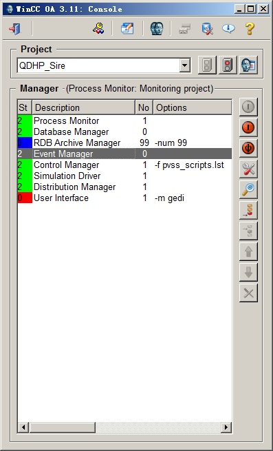

when I finish My RDB Setting then start my wincc oa project.
Including the configuration of environment variable, the configuration on config file of wincc oa and the configuration of RDB in GEDI.
but I can not start my RDB manager successfully.
FYI, My dongle have RDB license.

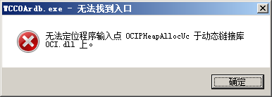

When my console try to strart the RDB manager, It showed a dialog.
Then text of the dialog is "Can not locate program input point OCIPHeapAllocUc on OCI.dll".

Re: RDB connected error on WINCC OA start
at the WinCC OA online help it is described that you need Oracle 11.2.0.2.0 or a newer version.
Maybe this is the problem why it does not work at your computer.
Please install the required version.

OK, I change oracle version from 11.2.0.1.0 to 11.2.0.3.0.
Problem Solved!
