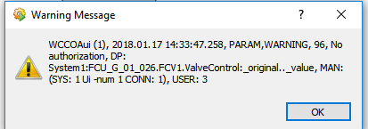

Good day all ,
Please have an issue with the security , as I a have configure multi security groups with different permission . The problem is when entering with a user that have only visualization permission and he try to change a value the attached message that the user doesn't have permission keeps showing even if pressed "ok" multiple times and then it hangs . So do you suggest any solution
thanks and kind regards Image

The '_auth' config could result in such message.
Re: Security warning message
I suppose that you are using the Para module in that case.
If the user only has the permission for "Visualization" you cannot change the original values using the Para module.
The panel for the configuration of the _original config is checking the permissions and if the user does not have sufficient permissions the configs cannot be changed.
