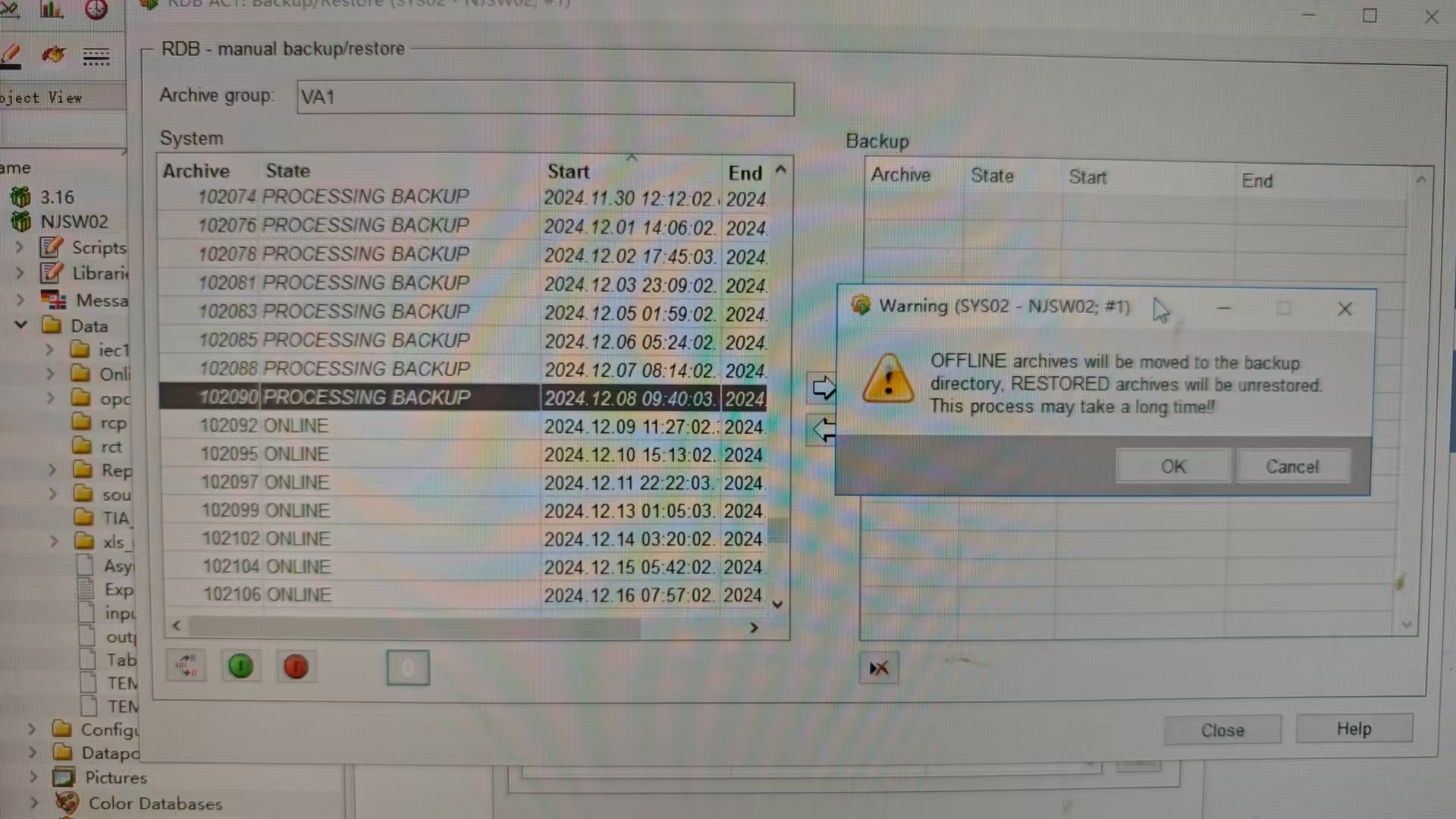

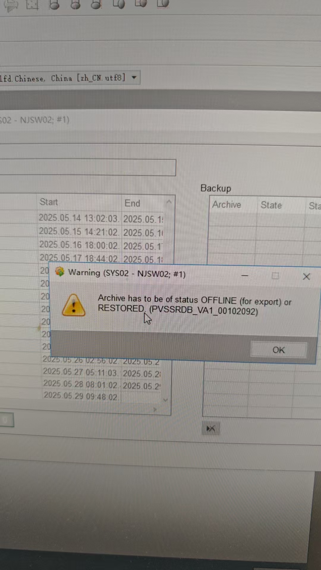

I need to consult everyone on an issue. In my project's Oracle database, the historical data files seem to be stuck when automatically switching from ONLINE to OFFLINE, all showing "PROCESSING BACKUP", which is causing the inability to perform RESTORE recovery,because the restore operation requires archive file to be with status of OFFLINE or Restored. Has anyone had experience resolving similar issues or have any suggestions?
OS: Oracle Linux 7.5
WinCCOA Version: 3.16 P028
Oracle Version: Oracle 12.2.0, RAC cluster with two servers
