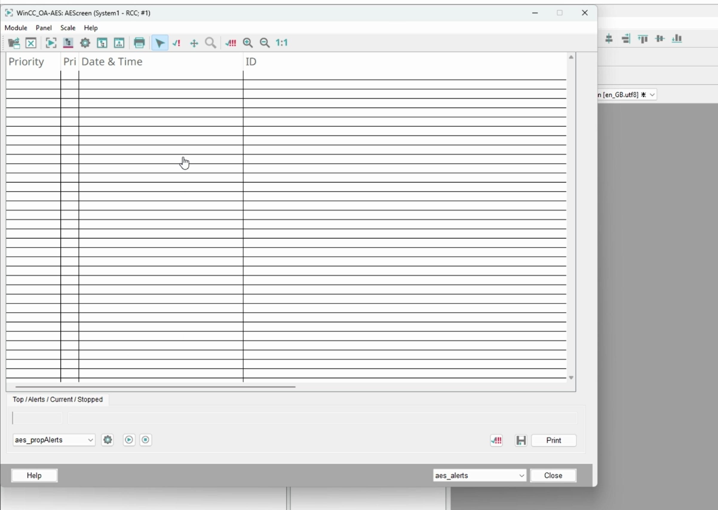

I'm unable to remove the Acknowledge all visible option from the alert screen's context menu.
All other options under Context menu settings in General AES settings can be enabled/disabled using the checkboxes. However the Acknowledge all visible option cannot be disabled
How can we disable the Acknowledge all visible option?
Is there a way to disable the entire context menu?
Thank you

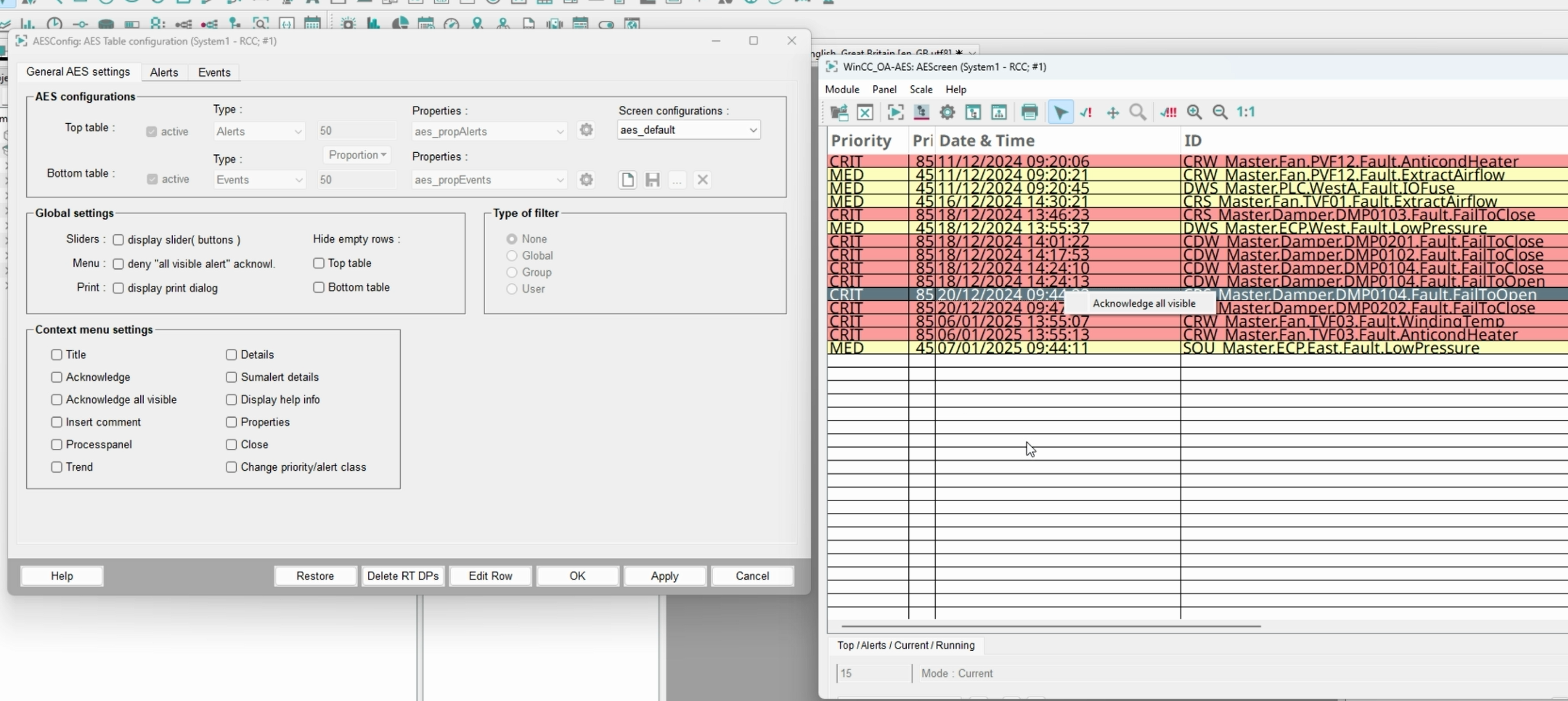

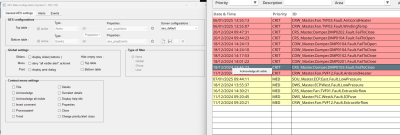

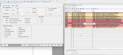

I have attached some screenshots of this behaviour when the alert panel is accessed through the gedi.
In our application we have embedded vision\aes\AEScreen.pnl without any modifications and supplied 1 as the value for the $ACTION parameter, when this panel initially loads it works correctly and does not display the context menu. However as soon as we set a filter and refresh, context menu starts to show up with the Acknowledge all visible option
(When accessing the alert panel through gedi, it initially comes up blank. When the start/refresh button is clicked alarms appear on the screen and the context menu is displayed incorrectly)

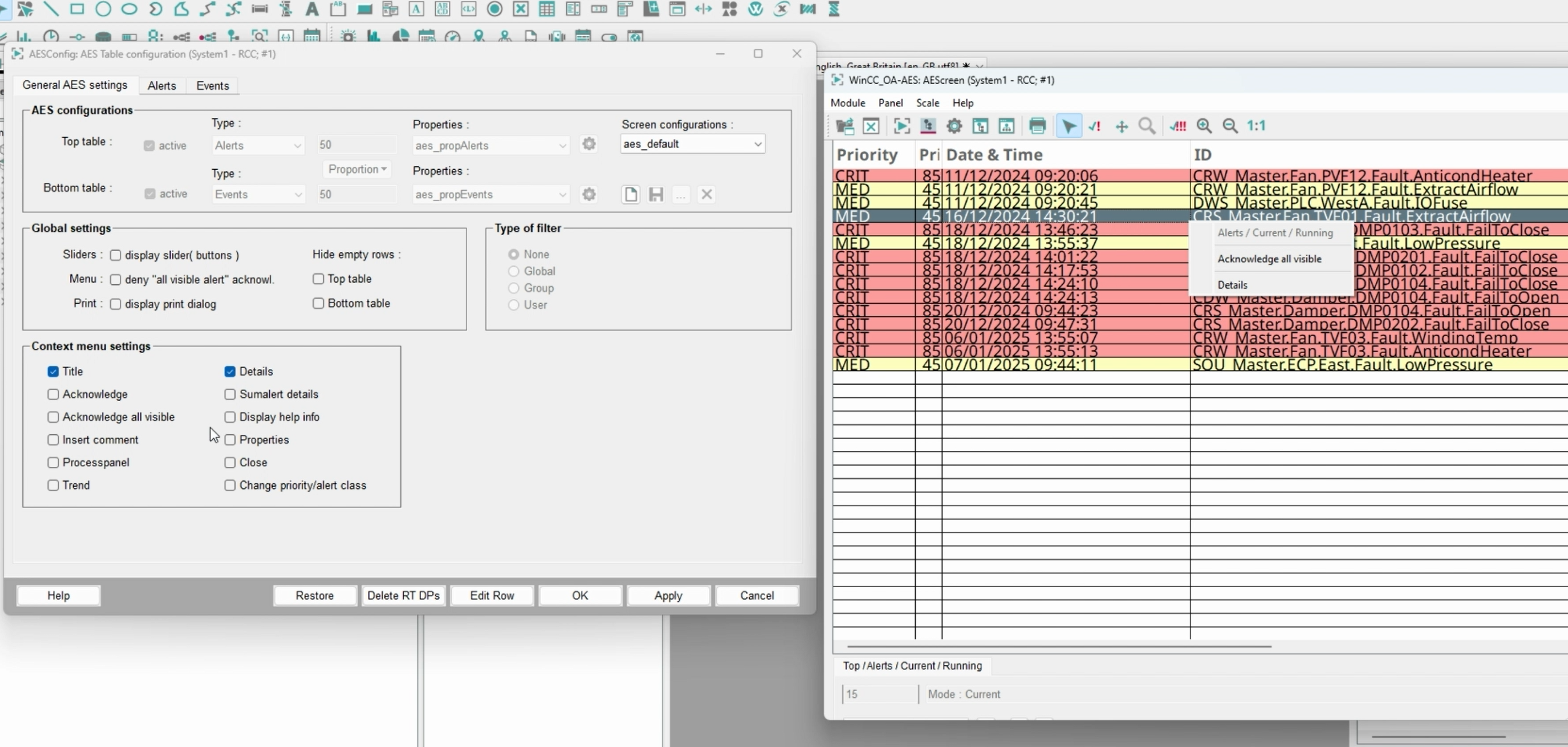

I have restarted the Alert panel. When our embedded AEScreen panel is initially loaded, the context menu is not visible. It actually starts appearing after restarting.
Also, changing any other checkbox works as expected. Only the Acknowledge all visible option stays visible even after the checkbox is unchecked.

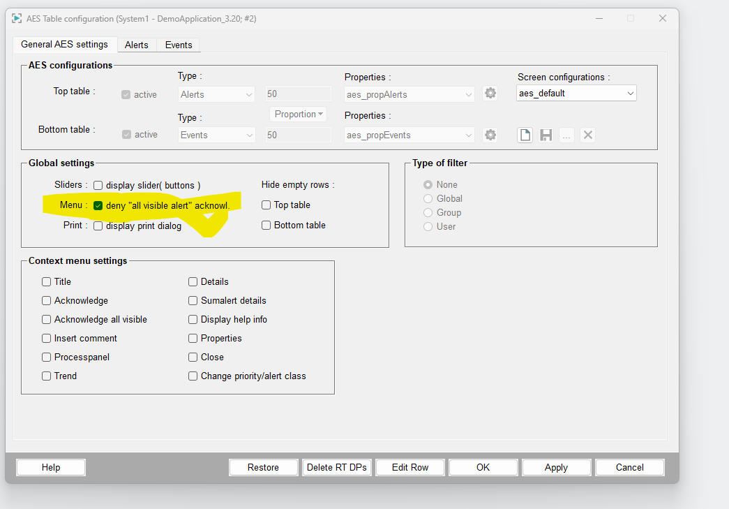

Figured out what was missing. Needed the highlighted option in Global Settings checked (screenshot below)
Didn't need to restart anything
