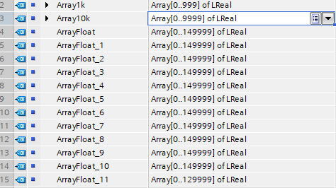

When I try to retrieve an array with size of 10k items(LREAL, 80000bytes in total) from a PLC using S7Plus driver, I receive an error as follows:
Unexpected state, S7PlusTrans, toVar, Data buffer too short (14472) for expected itemSize 80000
I need even larger arrays 500k items(4,000,000bytes). I was not able to find any configuration related to the buffer size of S7plus connection's data exchange. There are item related queues which does not affect the behavior (or I failed).

- I'm using offline project export. (see the datablock in plc attached) Export size becomes 300MB if you configure only one DB with the attached configuration which is also strange and unacceptable.
- Just regular input address configuration, using a dyn_ type datapoint element. Tried both subscription and polling.
- See attached

ozangor wrote: Sun Jun 23, 2019 8:47 pm- Just regular input address configuration, using a dyn_ type datapoint element.
I have no idea what you mean with a regular address configuration. Does it include the size of the array, for example: 'Array1k:1000'? If not, does it work if the array size has been added?

Selecting the item from the TIA export automatically adds the length of the item.
This is the error message I receive:
This means that array address configuration has 10000 in it already so it knows the size of the expected message(80000 bytes). However, the buffer seems not to be adapted accordingly, and the message cannot be received. Sometime it receives some amounts of data (1800, 2700) but never complete.
That's really a strange behavior and probably can be considered as a bug.

The error message you get directly points to the fact, that the S7+ driver expects 80.000 bytes of data being sent from the PLC for 10k items of size LREAL. However, the PLC only sends 14.472 bytes of data, which is simply too little for correct data processing. You really have to consider some limitations on PLC side, especially a maximum size of single variables or data messages.
If you must deliver the PLC-arrays as dyn-elements to WinCC OA I recommend splitting your arrays into shorter ones so that the PLC can send them successfully. Calculating backwards from 14kByte to LREAL array would mean ca. 1800 items.
