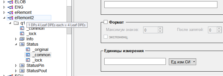

We have dp type "eRemont2" with only one 1 dp without aliases. "Select alert" from 1 dp takes 1,7 seconds if we use alias filter and don't find alias.
SELECT ALERT    '_alert_hdl.._ack_state', '_alert_hdl.._ack_time',   '_alert_hdl.._add_value_7',   '_alert_hdl.._add_value_8',   '_alert_hdl.._class',
   '_alert_hdl.._direction',   '_alert_hdl.._ackable',   '_alert_hdl.._value',   '_alert_hdl.._text',   '_alert_hdl.._system_time',   '_alert_hdl.._comment',
   '_alert_hdl.._value_status64'
FROM '@*1*#'  WHERE  _DPT = "eRemont2"

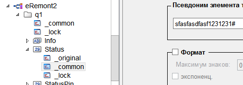

Then we set alias “sfasfasdfasf1231231#”, and run query again. Execute time is 0.147.
Any way these queries don't find DPE with alert_hdl. Why does it take such time? Why if we have found one DPE with alias, it takes 0,147 seconds, but if not - 1,7 seconds?
WinCC OA 3.14 patch 24

I have tested with WinCC OA 3.16 and executing the same query (with a different DPT as filter) takes only a few or 0 milli seconds and an empty result is returned.
How many datapoints are defined for the DP type eRemont2?
Can you observe the same behaviour in another system?
As I wrote above, just 1 datapoint. And this DP type is not used in other DP types as nested.
Yes, we tested this query on different projects, but not with WinCC OA 3.16
Re: Problem with queries with filters on aliases.
I have tested it again using WinCC OA 3.14 and also with this version I cannot see a long timespan for the query if no result is returned.
If you need further assistance please get in contact with your common WinCC OA support.
