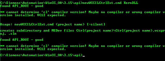

When you look in your Windows Start menu then you'll see something called 'Developer command prompt for VSxxxx'. When you open this command prompt then the path to cl will be ok.
* Choose 'Developer command prompt for VSxxxx'
* Now type 'cl' and press enter
* it should not display the version number for cl
* Stay in this command prompt
* navigate to c:\\siemens\\....\\API
* start checkapienv
* It should now say that the API_ROOT is ok and that the cl version could be read
* Now use the batchfiles to make DLL
* Go to the folder where the solution file is *.sln
* Type the name of the solution. Example. type 'mysolution.sln' and press
* (Always stay inside the command prompt)

First many thanks Frenk to take time to help me.
I started the command prompt. the "cl" command is not valid. and the checkapienv return "cannot determine cl compiler version" again

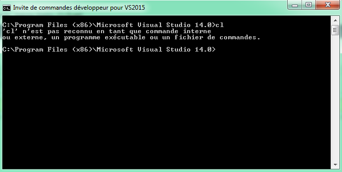

I did it. Sorry my prompt is in french but similar to your's

Re: Using DLL on WINccOA project
Frenk Mulder wrote:
cl.exe is missing due to an uncomplete installation of C++. I must reinstall it with custom option on VS2015.
Please look in attachment.
You must use the pompt that comes with Visual Studio and not just any prompt !!!!
The prompt that comes with Studio will set the proper 'path' in your command prompt
https://www.winccoa.com/fileadmin/image ... prompt.zip

I'm not sure about the compatibility with vs2015. I still have error messages when i want to use wincc_OA scripts. I'll try tomorrow with a VS2013 installation. Thanks Frenck or your help
