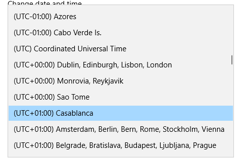

if the time-setting has a positive offset on UTC thus UTC+1 and further. All seems to work fine
If we apply a timezone UTC-1 and further the Option: Empty If Zero doesn't work anymore.
Could it be that a Negative offset on UTC give internally a 1969 year?
With simply changing Timezone and restarting of UI the effect is reproducible in our environment.
