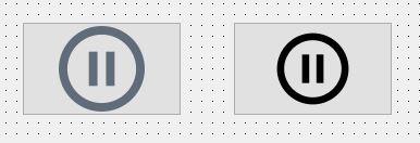

I'm trying to use .svg format images in WinCC OA. I can fill the pushbutton with the image that I want by dragging (so nice).
But, when the color of the image is "white" with "transparent" background, it automatically changes to black and the size. I don't know why.
It only happens with "white" images, not other colours.
I will attach an example of 2 pushbuttons with 2 different svg images (1 same image but 2 different colour) but with the same resolution.
Pd: I'm using WinCC OA 3.16 P015 in Windows 10.

I mean, you can drag the image from the "Project View" window to the pushbutton to configure it.
I realised that if the color is 100% "white" (RGB = 255,255,255) causes error..
I have attached 3 different examples of the same image (Green, Red, White).

Oh... I can't attach SVG image... what is your email address?
Re: SVG Image
In that case please get in contact with your common WinCC OA support.
Then it is easier to share data which is needed for the analysis.
