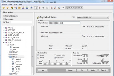

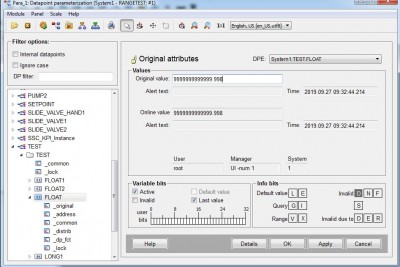

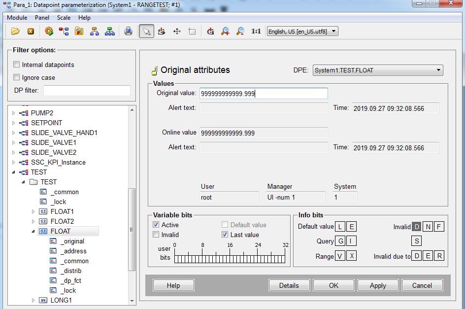

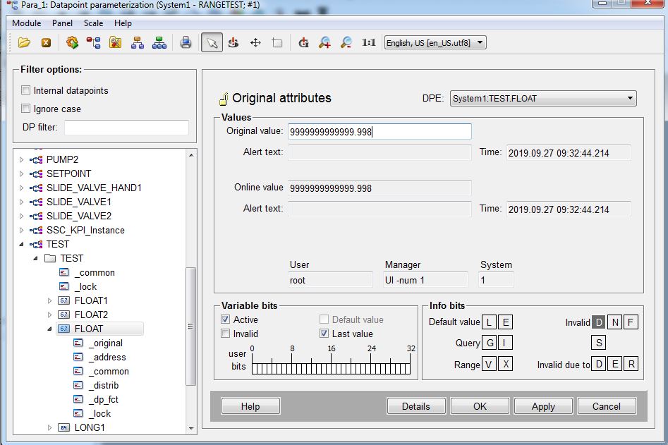

Up to 18 digits including the decimal point should be used. (0~ 999999999999999.999)
i tested by enter Original value from 1 to 18 digit sequentially.
ex)9.999 -> 99.999 -> 999.999 -> 9999.999 -> 99999.999 ...
but erroneous value is occurred since 16 digit.
according to Online Help, WINCC OA can express -1.79769e+308 to +1.79769e+308.
is that bug?

Re: float type digit error
the problem is not the panel but a misunderstanding of how floating point numbers work.
To simplify: A 64bit (double precision, used in WinCC OA) floating point number has only about 15-16 significant digits.
This is why you see your accuracy problems occur.
To be clear: This is not a bug or a specific behaviour of WinCC OA. This is how floating point numbers work in general (e.g. on your computer, in your PLC, ...).
I recommend reading up on floating point numbers to get a better understanding of how they work and their limitations.
