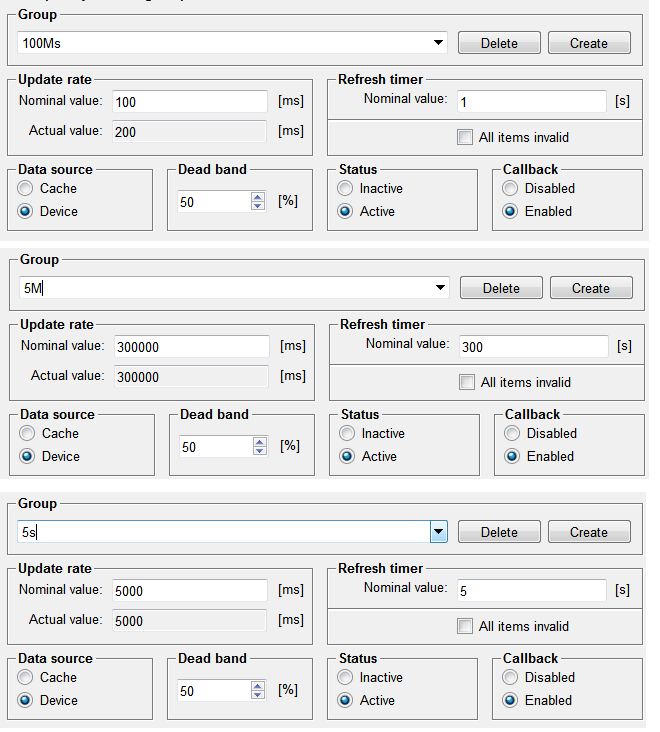

I have a problem with the configuration of the OPC driver groups, I have 3 groups configured as shown in the attached image, when I configure a DPE with an OPC addres and assign any of the groups I configure it with low level old / new comparisor so that the value is not overwritten unless the value changes; additionally configure a smoothing "old / new comparison" to avoid overwriting the value; but the address continues to overwrite the value I appreciate if you can help me with the problem.

the attached video shows how the system is writing the data and in the attached images you can see the configuration of the group and the DPE
The increments of 1 millisecond are because the timestamps of the values are not in sync with the WinCC OA server (in the movie the invalid info bit 'S' indicates this). Check if the time is correct on the OPC DA server and device. Or let the opc driver ignore the timestamps by setting the 'opc' config entry 'timeStampFromServer'.
The values read by the refresh timer have the general query bit set (in the movie the query info bit 'G' indicates this), which are not smoothed with the '_Driver.SM = 1' setting. Disable the refresh timer by setting to zero or use a much bigger interval.
