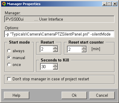

We use the -silentMode option in the Manager console to start panels invisible for some time now and it works fine.
-p "Typicals\\Camera\\CameraPTZSilentPanel.pnl" -silentMode
After installing official patches 6+13 on our running version 3.10 SP2 a xxxx.mdi file is created when we start the User Interface from the manager.
The panel works fine but I don't want to print anything.
What can we to disable the automatic screenshot print action?
Thank you.
Marcel Werksma

Thank you for your reaction but nothing was 'printed' before the patches.
I have read the silent panel help file but I could not find a way to turn it off.
I know that normally a CTRL manager is used but we had some problems
and the panel we start contains an ActiveX with events which cannot be
done with a CTRL script so is there a way to disable the printing?
Marcel Werksma
