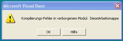

when following the WinCC OA help information to configure the Excel-report,
this error is displayed by Excel:
Is this problem caused by WinXP OS or Excel or WinCC OA?
Computer runs a WinXP 32 bit and Excel 2007 SP2.

Try to register MSCOMCTL.OCX in cmd.exe.
C:\\Windows\\System32\\regsvr32 mscomctl.ocx

if the problem still occurs after registering the mscomctl.ocx-component you could run the attached VB-script.
The script checks if necessary components for the Excel-report are installed.
Please send the result and a detailled problem description to the official WinCC OA support.

please let me report the result directly here. It is unclear what email address to use. Please forward this report to your support. Thx.
check environment for PVSS Report
create object 'Forms.SpinButton.1' ... OK
create object 'Forms.ListBox.1' ... OK
create object 'Excel.Application' ... OK
create object 'MSComCtl2.DTPicker' ... OK
create object 'MSComctlLib.TabStrip' ... OK
create object 'ADODB.Connection' ... OK
create object 'SubTimer.CTimer' ... failed 429: Objekterstellung durch ActiveX-Komponente nicht möglich
create object 'PVSS00Com.ComManager' ... failed 429: Objekterstellung durch ActiveX-Komponente nicht möglich

The output for the VB-script describes that 2 necessary components are not installed or registered.

There are new patches and batch files available for this solution. Please contact support for this solution.
Issue also exists for MaPara tools
WinCC OA x64 on x64 OS with Excel 32-bit.
