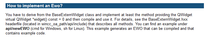

As reading the documentation, i came to know we need to inherit from BaseExternWidget and implement one of the method.
we need to copy the BaseExternWidget to our project file?.
And inherit the the user defined class from BaseExternWidget?.
Then do our implementation by creating the user defined classes according to the requirements, in our project and then compile as .dll
can you provide the guidance in understanding the documentation about BaseExternWidget?
Regarding the Base Class adding to User define Class

In the WinCC_OA installation, you find the file 3.14/api/README.NT
This explains to use the "newEWO.cmd" script to create a sample template ewo.
This simple ewo can already be compiled and used and the code includes additional comments and TODO commented
lines explaining what needs to be done.
Just follow these, it's really simple.

Re: Regarding the Base Class adding to User define Class
Thanks for the document.
And the image attached in the previous post , what does it infer then , which method do i need to follow?

The bitmap just says that your C++ code should derive from BaseExternWidget just like my example does.
I'd suggest that you use the 'newEwo.cmd' batch file in your API folder. This shoudl give you the proper framework for starting.
Personally : I started using Qt Developer to first learn Qt. Then, after going through some of the samples, you can try to write an EWO.
Good luck
Good luck

K i will go though the documentation and is newEWO.cmd mandatory to run to create the EWO?.
- fmulder
- Posts:330
- Joined: Wed Feb 03, 2010 9:46 am
No, the 'newxxx' batchfiles are just quite helpfull. You can use them or can decide to copy and modify an earlier project.
