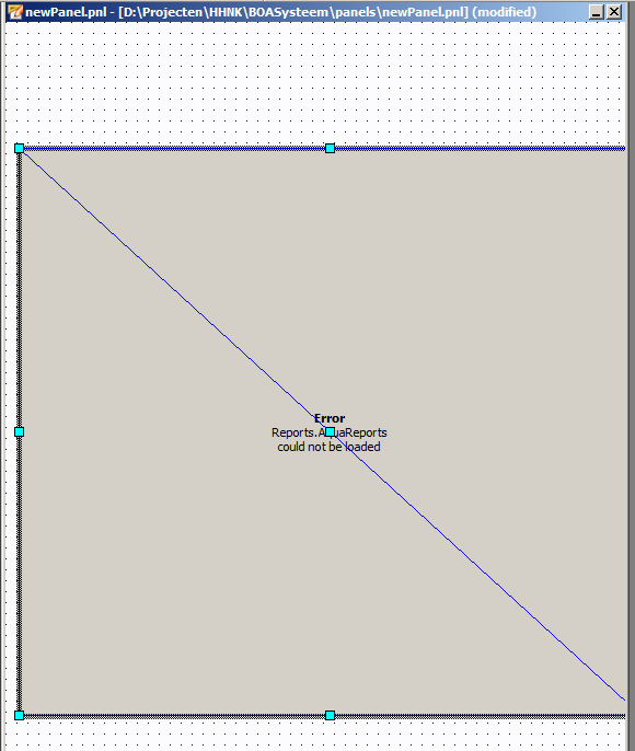

I've made an ActiveX object using C# .NET.
In this object i'm using the WCCOCOMLib.dll and calling some standard methods as isConnected(), dpSet() an dpGet().
Now I want to place this object on panel, but i get this error:
WCCOAui1:WCCOAui      (1), 2013.01.18 11:32:33.751,WORK,Panel::mouseButtonEvent:2 Button:1
WCCOAui      (1), 2013.01.18 11:32:34.813, SYS,  WARNING,    15/uim,
    Module: Gedi_1
    Panel: D:\\Projecten\\HHNK\\BOASysteem\\panels\\newPanel.pnl []
    Object: 0 named: "" of type: Reports_AquaReports
, Could not initialize ActiveX Object "Reports.AquaReports"
WCCOAui1:WCCOAui      (1), 2013.01.18 11:32:34.807,WORK,Panel::mouseButtonEvent:3 Button:1
WCCOAui1:(UNSYNCED!) WCCOAui      (1), 2013.01.18 11:32:34.812 CPVSS::isConnected()
WCCOAui1:(UNSYNCED!) WCCOAui      (1), 2013.01.18 11:32:34.812 CPVSS::dpNames()
Is there any way to get to finding the specific reason for the object not working? This error doesn't get me any further.
Are there any special methods, or settings that I need to include in the code?
If there is more information needed, i'm willing to post this. Just let me know what you need.
Image Thanks

Jeroen,
Try the Dependancy Walker. It could show you that certain DLL's are missing.
http://www.dependencywalker.com/
Run this tool, locate your ActiveX.
Also, try running the GUI from your debugger.
- Setup PVSS00UI as the program to run when debugging
- add the arguments '-currentproj -m gedi'
Good luck
