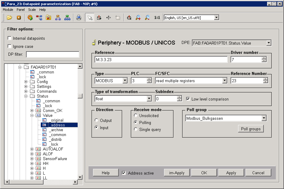

I'm using modbus driver for float variables, your description seems like an endian mismatch between your device and the WinCC-OA modbus driver
please look into the help, modbus-TCP-driver, config-entries: littleEndianRegister (but I had expected that this byte-swap then also was needed for the integers.... But in modbus devices you can have byte swap in a word/integer, and a word/integer swap in a float....)
Please see attached screenshots for the address-config I've used.... just for your information....
good luck...
