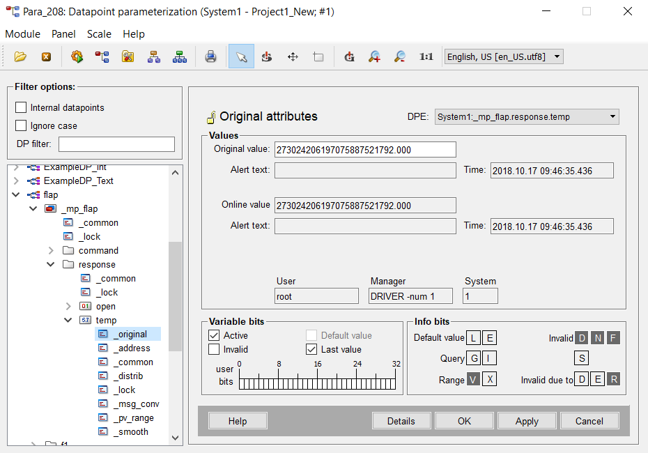

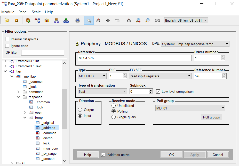

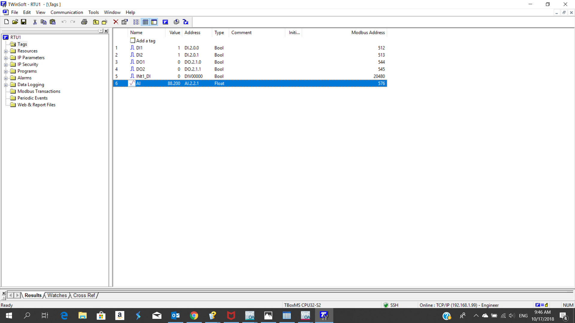

Hi all,
am trying to connect my winccoa demo project with an RTU through Modbus driver, its showing some values (not exactly the values stored in RTU) , here am attaching 3 screenshots, pls give me solution for this https://www.winccoa.com/fileadmin/image ... hot_10.png Image Image

It looks like you want to read 32bit values from a TBox RTU, which uses big endian. So setting the following config entry should resolve your issue:
[mod]
littleEndianRegister = 0
But to make use of the buffering functionality of the device you could better use the IEC 60870-5-104 or DNP3 protocol.

Hi Gertjan van Schijndel ,
Thanks for your support.....now i am getting the exact values.... :woohoo:
