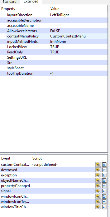

I am currently trying to customise my context menu within a activeX PDF viewer in WinCC. I have set the extended property 'contextMenuPolicy' to CustomContextMenu. I then noticed that there is a script within the extended tab called customcontextMenuRequested, however it does not provide any help as to how to code what actions/menu items I want to be disabled/enable within the context menu.
Can anyone please provide some help or code example that I can work from?

I guess that you can only replace the default context menu with our own context menu (not modify the context menu). With the function 'popupMenu(XY)' a context menu can be activated.
Have you checked if the event is actually triggered?
