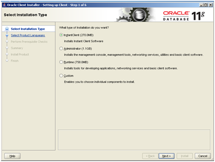

Have you installed the Oracle CLient software in the Administrator mode or something else.
It should be install under Administrator mode.
R.Parameshwaran

- Natty
- Posts:34
- Joined: Mon May 23, 2016 2:08 pm
Re: RDB Manager and Historical service stopped working
I can't remember as I did 2 years ago. Though it used to work for several months so I would say that I did install it with Administrator mode.

- paramesh1985
- Posts:81
- Joined: Thu Sep 25, 2014 6:03 am
During the installation of oracle client software in the scada server,client ; it will prompt to select the type of installion. In that you have select "Administrator" mode.
Could you please tell me which mode you have selected during installation.
R.Parameshwaran
R.Parameshwaran
- Natty
- Posts:34
I selected "Administrator" mode. I can't figure out how to link a file.
