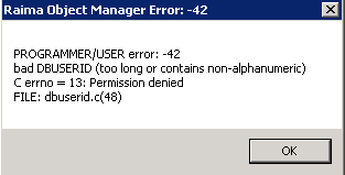

HI,
During the project start up there is a "Raima Object Manager Error:-42" got appeared. But still the project is running.
Any one have any idea about the attached error.
Software version : PVSS 3.9 SP1 Image
Re: Raima Object Management Error -42
The problem is that the operating system user which is used to start PVSS has invalid characters and/or blanks in its username.
Please change the username or use another user.
Post by paramesh1985 »
Thanks. My problem got solved.
