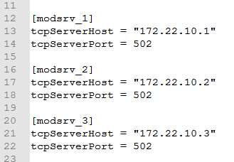

I am in the process of creating a WinCC OA project, which require the setup of a 1 Modbus driver (Client) on one machine and on a separate computer a set of Modbus TCP servers, whereby each has its own manager. My question is here: What is the maximum number of MODBUS TCP Server managers can be defined in the console, since I am planning to setup about 250 managers on the Modbus Server WinCC OA project? If there is a limitation, is it possible to extend the number of managers allowed?
An excerpt of the config file is attached below.
