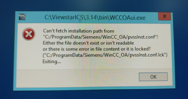

Hi all,
I have seen several times the following error appearing after a power failure in the WinCC OA servers:
Can't fetch installation path from
"C:/ProgramData/Siemens/WinCC_OA/pvssInst.conf"
Either the file doesn't exist or isn't readable
or there is some error in file content or it is locked?
("C:/ProgramData/Siemens/WinCC_OA/pvssInst.conf.lck")
Exiting...
I have seen this happening in several different projects.
Last time this happened I had two redundant systems, and this file went corrupt in the four servers!
Is there a reason for this to happen?
Re: Error: Can\'t fetch installation path from \"C:/ProgramData/Siemens/WinCC_OA/pvssInst.conf\"
If the file is corrupt after a power failure the cause for the error is the power failure.
In a plant environment you have to use a UPS to ensure that the system is stopped properly if a power failure is detected.
If no UPS is used and a power failure occurs the operating system, files of the operating system and also parts of an running application can be affected, e.g. the database of the WinCC OA project.
