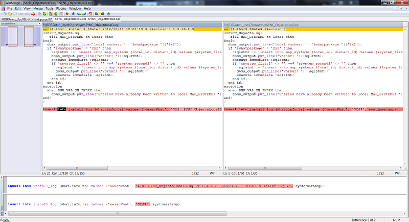

for an upcoming update of the software at our customer, I compared the RDBSetup scripts between the current and the new version.
Current: WinCC OA 3.14 Upd 10
New: WinCC OA 3.14 Upd 19
I've found that your placeholders are not defined in the scripts anymore.
Is this intended or a mistake?
Does this have an effect on the update itself?
Re: Placeholders not defined RDBSetup scripts?
I compared the scripts in 3.14 Final and 3.14 patched version and I have seen the same difference.
As the file in the patched version is the same like in WinCC OA 3.16 it looks like the patched version is the correct one.

Ok, thanks!
