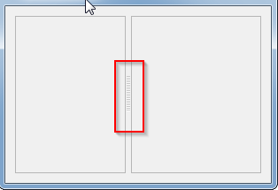

we have a module and in this module we have two trees.
We also use a horizontal layout.
Is there something like a spliter (see image) in 3.16 to resize the trees?

There is no splitter.
A workaround might be to use a docked module (see moduleAddDockModule())

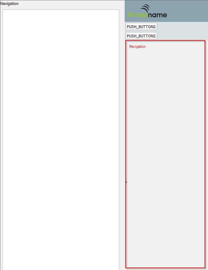

Is it possible to add the dock module to a embedded module?
We would like to draw a fix header and a dynamic tree like the image bellow.
https://www.winccoa.com/fileadmin/image ... module.png
Re: Layout management splitter
No, dock windows can only be docked into main windows (Modules which have a window).
But you can implement a splitter on your own, e.g. like in the attached example panel. https://www.winccoa.com/fileadmin/image ... litter.pnl
