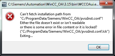

When I start wicc oa, I see the error.
I try to modiy and remove and the new setup.
But I still see the error when I start wincc oa.
How can I fix the error?
Please let me know? Image

please move the lock file pvssInst.conf.lck to another location (/ temp).
After that it should be possible to start the project.
Please check, if in the pvssInst.conf the projects are registered correctly.
