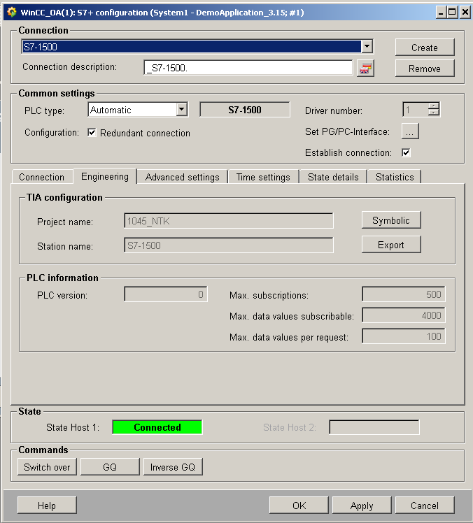

I’m trying to import the PLC tags from a TIA Portal Project into a WinCCOA 3.15 application. The videos I keep finding online showing how to do this have a different button option compared to what I’m getting.
The screenshot attached shows an “Export” button where all the videos have “Importer” in its place.
It seems like this is the only way to import the tags, since after this they become visible in Para.
Any idea how to get the TIA Importer function working properly?

Just had look into my 3,15 P010. Button have label "Importer".
Are you using latest patch as well? Maybe there was some mismatch text in the previous version...

I'll try updating it and see.
The button itself still goes to an Export feature, so it's not just the text that's off. Hopefully the update fixes this. I'm going nuts.
