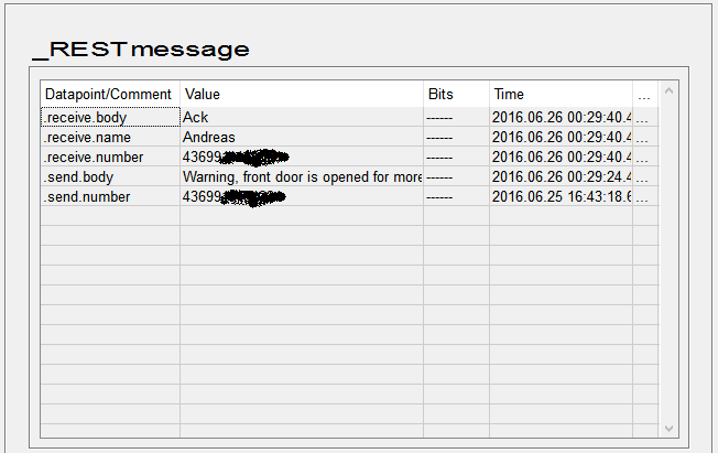

I try to log in with SSO via ULC UX. This works, even if the user is not yet created. (Then he is just created)
However, my startup panel is not displayed to me. The following message appears "You do not have permission to switch on this panel"
In the para I see changes in value that there is no user in the system.
Can someone help me there? Image
