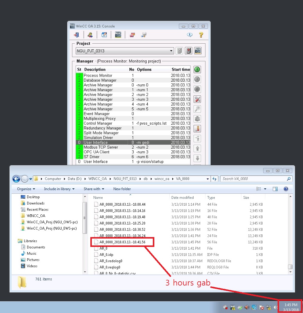

This log-For your understand, I attached a file.
As you see the picture, date of DB file name is AR_0000_2018.03.13.-10.41.56.
But current date is 2018.03.13.13.45. I means there are 3 hours gab between DB file of date and current date. https://www.winccoa.com/fileadmin/image ... B_date.jpg

The file names for the value archives are saved with the time information in UTC time.
Therefore you see a gap between the time when the file switch was made and the name of the file.
