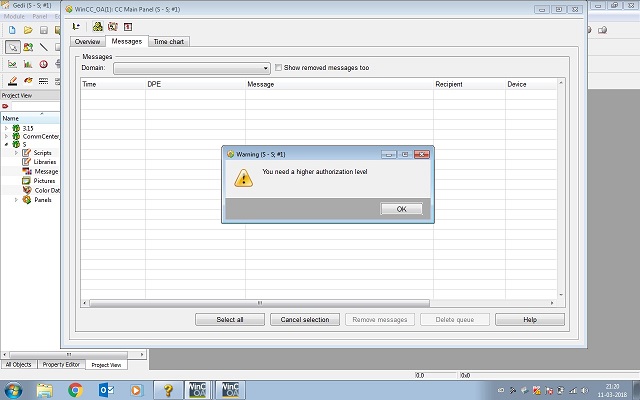

Hi Everyone,
I am getting an error message (You need higher authorization level) while opening parametring screen in the Communication Center for the more information please find the attached image. Image

There was a problem in 3.15 P006 which is already solved. Just try the latest available patch for 3.15 (P009 at the moment).

Hi
Thank you very much for the quick response.
