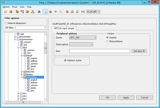

We have a problem about OPC UA periphery address config & excel import.
We have inserted periphery address config to masterdatapoint and as item we have entered “ns= ;s=”, then export them to excel.
After configuring addresses in excel for all the datapoints, we import it to the system.
After import part is finished successfully, in the para the power config part of the datapoints seems blank, subscription part is not selected and item part is blank. The panel is attached.
Do you have any opinion with this situation, could you please suggest a way to enter periphery addresses with excel import?

Thanks for your response.
I have tried with just the regular export and import that .dpl file, it worked with that.
We are using 3.12, I think there might be a bug with OPC UA powerconfig import part.
