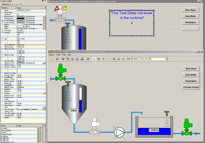

I recently upgraded from 3.15 p006 to p007, after the upgrade all my text is shown in magenta and will not show in the panels (runtimes).
I have tried to re-install and this issue is still present, I even tried to revert back to p006 and this problem still exists. However This problem is only since the upgrade and exists in all projects, even newly created projects.
I have attached screenshots using the sample projects
Any help would be gratefully received Image

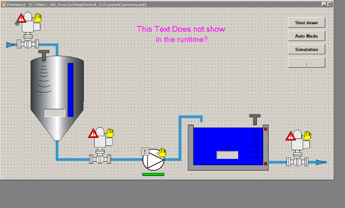

Previous post by Antonio, was done on my behalf.
Image showing the magenta text, the text is set to be black and enabled.

Please confirm that the property "foreground color" is set to black, not transparent.

I can confirm that the Foreground colour is set to black and a static colour.

Sorry I hand't seen your print screen.
I believe it might be because of having the border set to "None" instead of continuous

You are a Genius, that has solved the problem, I have no idea how that got changed.
