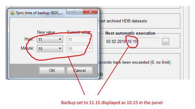

Seeing a small oddity in the Backup Panel. When I set a time of day for automatic execution, the main panel displays a time in the 'Next automatic execution' field one hour earlier than the actual time requested.
This is running on a Windows 7 machine with its time zone set to London UTC +00, and Daylight Saving Time enabled. However, no DST should be applied at the moment.
The backup does run: at the time set up, rather than the time predicted by the 'Next automatic execution' field.

I have tested it and I have seen the same deviation for the configured time.
This small bug was reported to our development department.

I was trying to say that setting up the automatic backup DOES work, but it runs at the time set in the 'Sync time of backup' dialog. NOT the time predicted by the 'Next automatic execution' field.

Re: V3.15 P007 Oddity in backup dialog
I have fixed the problem that the backup time is not set correctly.
The bugfix will be available with the next patch for WinCC OA 3.15.
