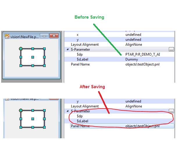

I've installed v3.15 Patch 008.
I have opened a configured panel made adjustments, saved and noticed that where I have previously configured dollar parameters some have now disappeared.
As the files were created with an older version I though I would try creating a object with parameters using the new patch.
I created a basic rectangle with 2x dollar parameters simply getting set into a string. Placed this onto panel, set the parameters up, saved the panel and they've gone.
Where have they gone to?

I initially spotted this problem as I opened a library panel, which was created using patch 6, containing an object with two dollar parameters.
After I upgraded, I opened the panel, moved the object by a pixel, selected save and watched as the configured dollar parameters disappear out of the properties.
I hope this helps you to replicate the problem.
