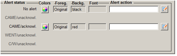

I wonder if someone can help me out with the following issue:
I have my alert class defined as the picture in attachment. When I then do a dpconnect to “…:_alert_hdl.._act_state_color”, I obtained the following results:
[ol][/ol]["display color:"]["red"] when the alert is active , which is what I expected.
[ol][/ol]["display color:"][""], when alert is not active(no alert status). I would expect to receive “black” instead.
Where am I wrong on my thoughts?

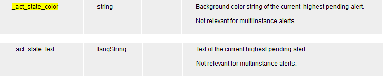

    I understand what you are saying, which was my first thought. But I then a tried to do similar exercise with "_act_state_text" and the results are:
    ["display text:"][1
    WCCOAui2:LANG:10005 "IED comms Fail"
    ["display text:"][1
    WCCOAui2:LANG:10005 "IED comms Healthy"
    Seems like it works even if no alert is active.
    Looking on the "help" section(Prt Scr), I would not expect different behaviors btw "_act_state_text" and .._act_state_color"?
