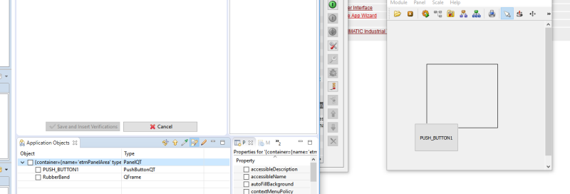

I found out that squish is not capable to detect the rectangle,am I right?

That should work with P007:
29265: Now automated Squish tests are able to query the following
shape properties:
QString foreCol, QString backCol, bool visible, bool enabled,
bool selected
Br
A. Daneau

Yes all shapes which are not widget (rectangle, primitive text, circle, polygon, ellipse, ...) cannot be accessed using squish picker.
You need to use script for that. Ex:
function main()
ctx = startApplication(PVSSII_PATH + "bin/WCCOAui -currentproj -p yourpanel.pnl -lang de_AT.utf8 -user root:");
var panel = waitForObject(":etmPanelArea_PanelQT");
logProperties(panel.getShape("PRIMITIVE_TEXT1"));
logProperties(panel.getShape("PRIMITIVE_TEXT2"));
function logProperties(obj)
var text = obj.property("text").toString();
test.log(text);
var textList = obj.property("textList").toStringList()
for (var i=0; i

Is there any documentation to understand for example what is ":etmPanelArea_PanelQT"?

I worked a little bit on Rectangle shape.
It works!!!
I wondering if there is any docu or if we can share some experience about squish and WOA in order to understand what is possible and what is not.
I am open for a telko if you want.
