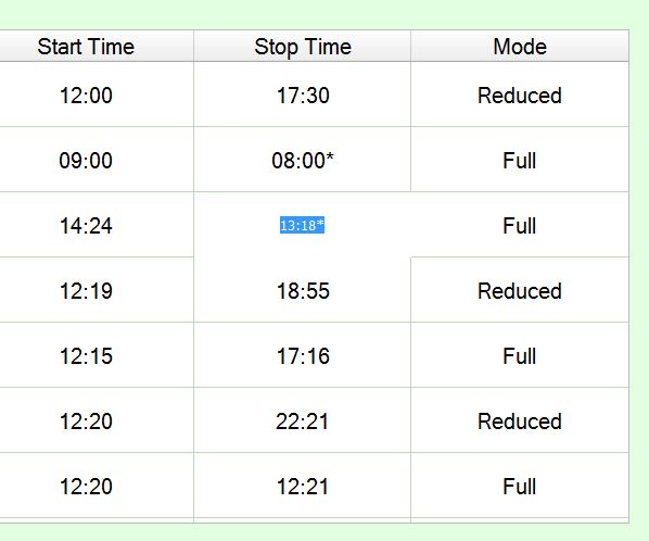

Table cells change font size when selected

Yes. I've also seen this behavior. it looks a bit strange.
I was planning to investigate using a stylesheet. Maybe you can change the font of the editable cell with a stylesheet.
I did not yet have time to do so.
Hop that someone knows a fix for this. I'm using 3.15P007

I've tested and I've seen the behaviour.
The topic was discussed with our developer and at the moment we do not know if there is a possibility to change the behaviour.

As far as you have a CSS entry for tables, this is not happening.
Ex:
QTableView
selection-background-color: gray;
