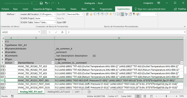

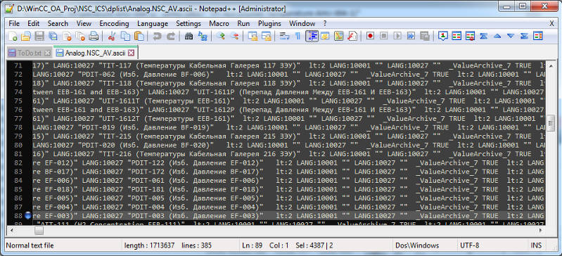

Please check the print screens in attachment. The texts in the ASCII files are display correctly in Notepad++ (detected as UTF8), but in Excel the text appears as gibberish. https://www.winccoa.com/fileadmin/image ... shot_2.jpg Image

This seems to be a problem with the way MaPara tool uses to read data from the ASCII file. The VBA function used does not support UTF-8 encoding
