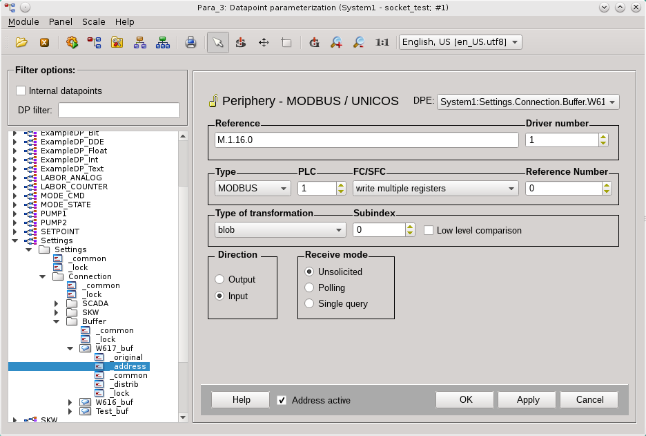

I have a problem. I have many controllers (about 100 pieces), these controllers can send telegrams to the system. That is, the Scada System must act as the SLAVE, and the controllers in the role of MASTER. I'm trying to create 1 DPE to listen to all the controllers at the same time, but I can not do it. Help, please, to solve this task.
Thank you in advance.
https://www.winccoa.com/fileadmin/image ... 171211.png

Installed version 3.14. In the driver settings, a new "Only active driver" menu item has appeared. Is this what I need? In the documentation about this innovation nothing is written. And what should be the Peripheral address configuration for DPE?
Re: Modbus master - slave communication
The option "Only active driver" is part of the Modbus TCP client configuration. Also peripheral addresses are only used when configuring a Modbus client.
Data which shall be provided by the WinCC OA Modbus TCP server is defined in a CNS view (Plant Model Editor).
