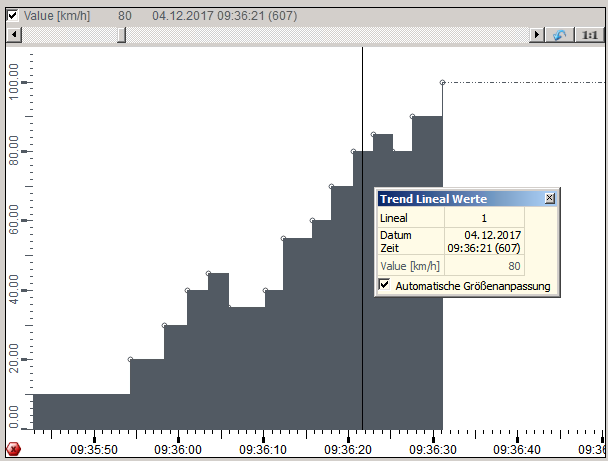

One of the functions of the Trend diagram is to display value-over-time curves.
Trends are provided for visualizing the changes of data point values over a specific period of time or for relating changes in different data point values to each other.
For example [value related to time].
