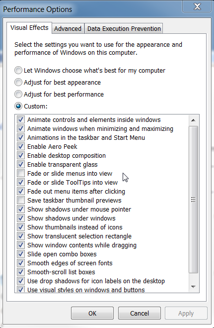

it seems to be a problem according a "fade effect", which is handled by operating system (Win7, Win10) settings.
As a workaround, please change system settings in windows.
[Systemsteuerung\\System und Sicherheit\\System - Erweiterte Systemeinstellungen]
[Systemeigenschaften] - Erweitert - Leistung (Visuelle Effekte, Prozessorzeitplanung, Speichernutzung und virtueller Speicher)
Auswahl aufheben:
de: "Menüs in Ansicht ein- oder ausblenden"
[Control Panel\\System and Security\\System - Advanced system settings]
[System Properties] - Advanced - Performance (Visual effects, processor scheduling, memory usage and virtual memory)
uncheck:
en: "Fade or slide menus into view"
with best regards,
Andreas Image
