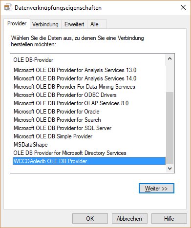

My options with 3.10 are limited. I was able to verify the OleDB driver of 3.15 gets listed in Excel 2016 32bit, see screenshot. You have not told which Excel version you are using right now. But it you are using Excel 64bit, you should try the 32bit version.
If you are unsuccessful with OleDB you could also give the COM manager a try. 3.10.2 is also an option.
