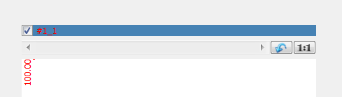

Hello.
As you can see in the image it works fine.
The style entry is correct.
Pls place the attached stylesheet file (rename it stylesheet.css) into the config folder of your project to see the effect.
No different stylesheet is necessary.
Best regards,
Robert
