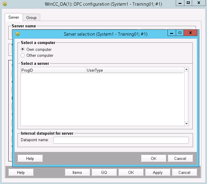

I have installed WinCC OA 3.15 server on VM machine and there is no WinCC OA OPC Server registered in OPC Configuration panel.

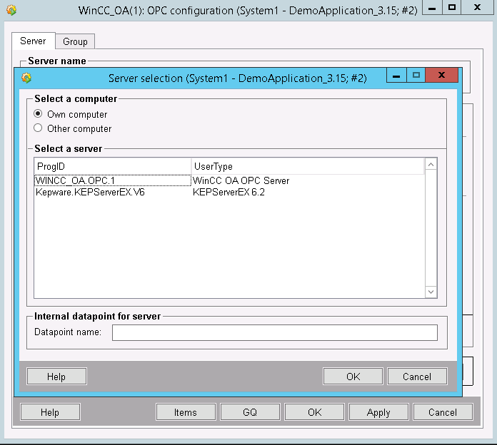

The same WinCC OA 3.15 server installed on physical Server, WinCC OA OPC Server is available in OPC Configuration panel.
Do I need to do any additional configuration to enable WinCC OA OPC Server on VM machine.

After using "Repair" function in "Control Panel" --> "Programs and Feature" OPC Core Components (x64) 106.0, WinCC OA OPC Server is available in OPC Configuration panel.
