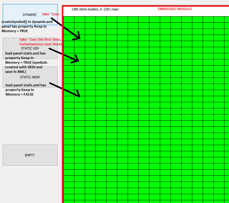

I think UI doesn't cache all shapes were created after Initialize event. Is it right or it should be work ?
Please, see below the picture.
it's related to this previous topic but i don't want to save panel.

Correct, panel-references loaded dynamically via addSymbol/createSymbol are always removed from memory when the panel is closed.
This is done to have the panel in the (kind of) same state as it was when it was first loaded (however graphical attributes are not reset).

I found only way to keep in memory : it is to load each panels in differents embedded modules and toggle visibility of embedded module to switch to the active view.
