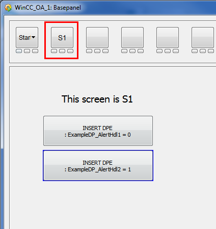

When the current screen is displayed, I want to indicate the different button color of the screen.
but when I click the screen change button, the button don't change the color in this screen.
I found the toggle function about the screen button, but this button doesn't turn off when the screen changed.
In general, I can change the button color when I insert the button in the DP element.
But I don't know how to change the color of navi button.
How to change the the color of navi button?
I attached the screen with TEMPLATE 1.

the affected panel reference is panels/objects/STD_PANELS/PT_sumq.pnl, where you can change the button color (shape "cmdPanelOn").

Thank you for your answer.
But I know this button where it is.
I mean, I always change the button color include DPE.
Maybe, you give me an advice about using the button name "cmdPanelOn".
But I don't know change navi button color without DPE.
How to change the the color of navi button only change screen?
please give me some advice about script.
Re: How to change the the color of navi button?
If the color of the buttons shall match the currently opened panel you can make a connect on the _Ui_.RootPanelOrigOn.* elements.
Everytime when a root panel is opened these elements are set. If the filename/panelname matches the criteria for a specific button you can set the color of the button.
